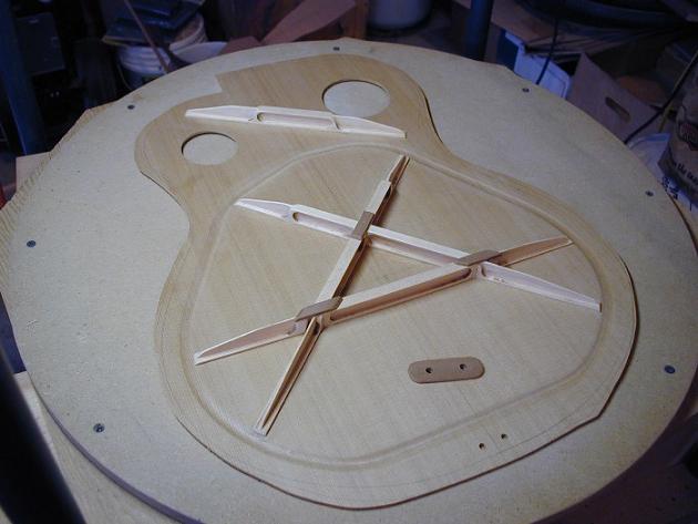

My feeling about the rabbeted edge is that it's trying to cure a problem in their hefty bracing rather than the top. Furthermore and more the point of concern is that they are creating a weak spot near the edge of the top because they are cutting the fibers there instead of easing the thickness from the outside.
PostPosted: Mon Jan 22, 2007 3:44 am
Posts: 1041
Dave,
   Agreed. Cutting fibers by routing across such a narrow channel can create
a drop in strength. The recurve of a carved top on an archtop is reatig he
same effect but without as much danger of loss of integrity.
Kevin Gallagher/Omega Guitars

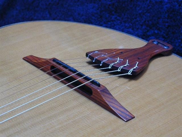

Here is the first example I ever saw of routing a channel around the top, its a Kevin Ko Guitar, and I believe he did this back in 1999 or 2000.
LanceK39104.5078703704
PostPosted: Mon Jan 22, 2007 6:52 am
Posts: 1041
Lance,
   I remember when Kevin did his rout around his top edge. He's a great builder with awesome vision and creativity. His "I" beam bracing was very cool, but slightly different from that of others that have used it. I've tried it on a few prototypes and really liked the tonal results.
   Do you remember his beautiful cantilever tailpiece and bridge system that he came up with around that same time? It may have even been on that very guitar. A great design that I believe he may have secured a patent on.
   I'll have to touch base with him just to catch up a little.
PostPosted: Mon Jan 22, 2007 10:20 am
[QUOTE=Kevin Gallagher] Lance,
Kevin Gallagher/Omega Guitars[/QUOTE]
Here is a link to the Kevin Ko guitar from the OLF archives. Kevin Ko guitar
It really is a thing of beauty as is all of his work.

Kevin, Yes I remember that tail piece, matter of fact Kevin Ko got a patent on the tail block.
You can see his patented Cantilevered tail block HERE
